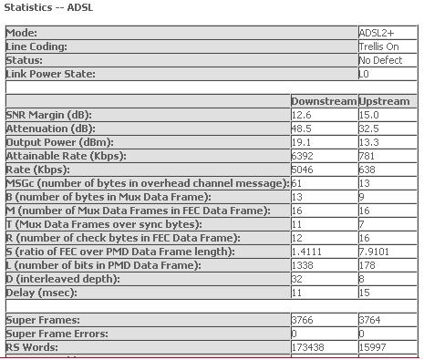

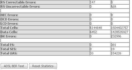

cooler602 Начинающий
Такая статистика модема нормальная?
Statistics -- ADSL
Mode: ADSL2
Line Coding: Trellis On
Status: No Defect
Link Power State: L0
Downstream Upstream
SNR Margin (dB): 21.2 21.4
Attenuation (dB): 15.5 9.8
Output Power (dBm): 19.1 12.4
Attainable Rate (Kbps): 13108 1256
Rate (Kbps): 7164 766
MSGc (number of bytes in overhead channel message): 61 13
B (number of bytes in Mux Data Frame): 30 11
M (number of Mux Data Frames in FEC Data Frame): 1 16
T (Mux Data Frames over sync bytes): 7 7
R (number of check bytes in FEC Data Frame): 14 16
S (ratio of FEC over PMD Data Frame length): 0.1378 7.9238
L (number of bits in PMD Data Frame): 2612 210
D (interleaved depth): 352 8
Delay (msec): 12 15
Super Frames: 16625996 16625994
Super Frame Errors: 0 70
RS Words: 3502624878 70660474
RS Correctable Errors: 3585 1309
RS Uncorrectable Errors: 0 N/A
HEC Errors: 0 1486
OCD Errors: 0 0
LCD Errors: 0 0
Total Cells: 244858415 3236151073
Data Cells: 44450266 259700071
Bit Errors: 0 72218
Total ES: 0 24
Total SES: 0 8
Total UAS: 15 127816
И вопрос как поменять path mode и где? |
