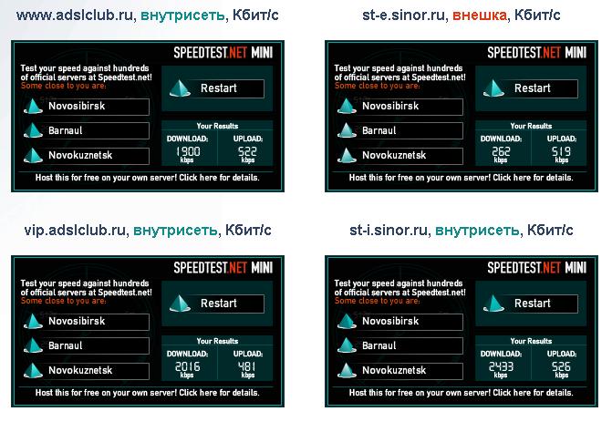

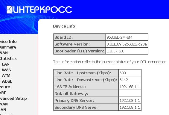

подскажите у меня безлимитный 256
нормальная ли скорость?
Statistics -- ADSL
Mode: G.DMT
Type: Interleaved
Line Coding: Trellis Off
Status:
Link Power State: L0
Downstream Upstream
SNR Margin (dB): 0.0 0.0
Attenuation (dB): 27.9 21.5
Output Power (dBm): 31.5 20.5
Attainable Rate (Kbps): 18 13
Rate (Kbps): 6142 639
K (number of bytes in DMT frame): 18 13
R (number of check bytes in RS code word): 111 20
S (RS code word size in DMT frame): 16 4
D (interleaved depth): 1 8
Delay (msec): 4 8
Super Frames: 1773 166
Super Frame Errors: 523468 523466
RS Words: 0 12119
RS Correctable Errors: 58628478 4449461
RS Uncorrectable Errors: 949 N/A
HEC Errors: 949 2682
OCD Errors: 0 5766
LCD Errors: 0 0
Total Cells: 0 0
Data Cells: 121681616 43047183
Bit Errors: 0 0
Total ES: 0 0
Total SES: 0 303
Total UAS: 0 225

канал 6 мегабит, а скорость 2 мегабита. из области что ли?
