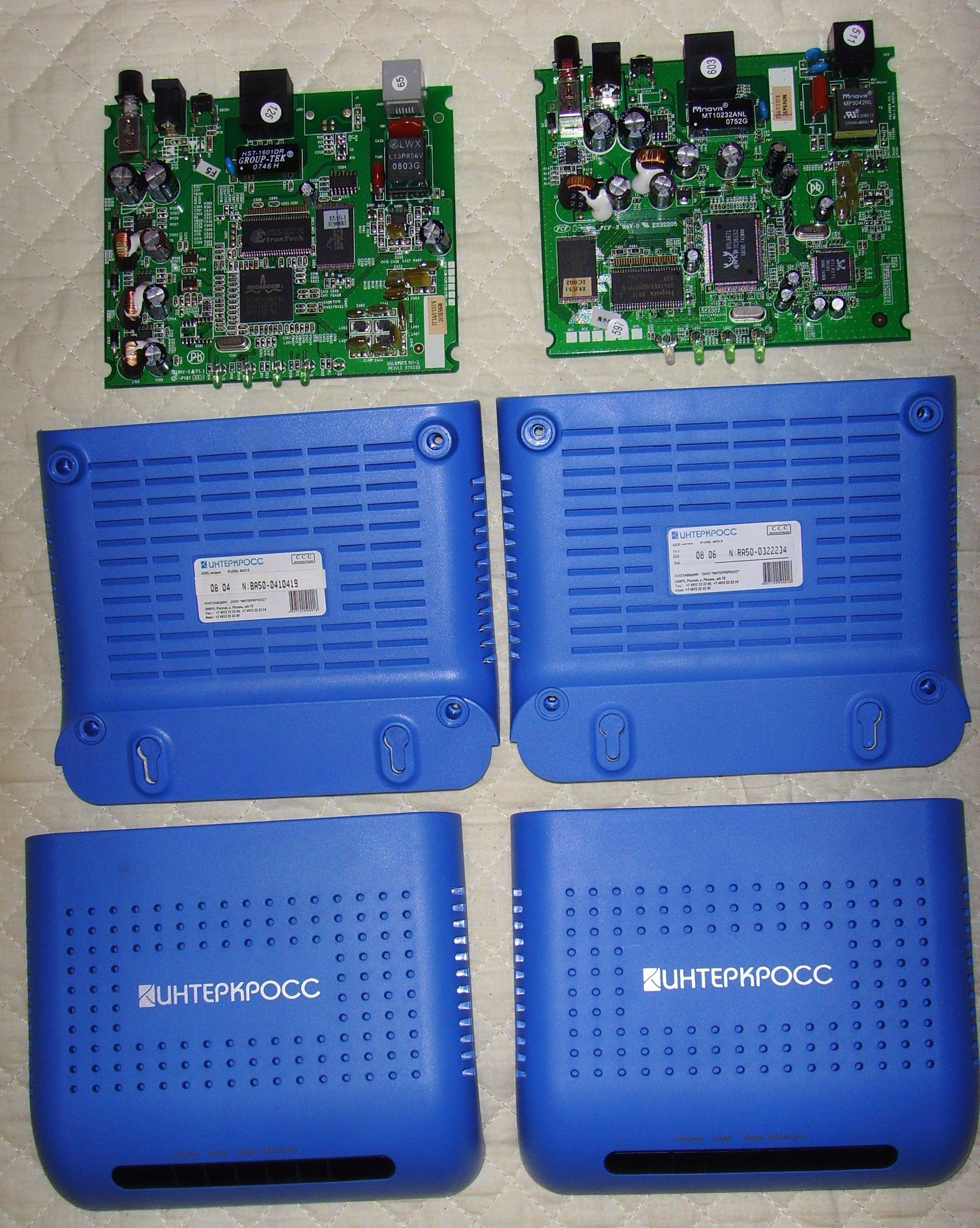

djlab Гуру
серийник 08 07 N RA50-0354382
и вот что в модеме
Mode ADSL2+
Latency Interleave
Trellis Coding Enable
Status SHOWTIME.L0
Power Level L0
Downstream Upstream
SNR Margin (dB) 16.3 7.8
Attenuation (dB) 24.0 12.0
Output Power (dBm) 19.5 12.0
Attainable Rate (Kbps) 20188 1113
Rate (Kbps) 18487 1113
K (number of bytes in DMT frame) 245 13
R (number of check bytes in RS code word) 10 12
S (RS code word size in DMT frame) 0.42 5.92
D (interleaver depth) 64 4
Delay (msec) 6.78 5.92
FEC 9935 11
CRC 107 0
Total ES 73 51
Total SES 0 29
Total UAS 0 41619 |
